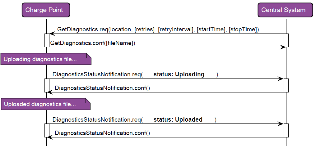

With this method, an OCPP server sends a Get Diagnostics request to the connected OCPP client. The response from the OCPP client is processed directly within the method.

Directory to which the diagnostic file is to be uploaded.
nRetries
UDINT
Number of attempts made by the Charge Point if the upload fails.
nRetryInterval
UDINT
Interval after which a new upload is attempted.
nStartTime
ULINT
Start time of the logging information contained in the diagnostics.
nStopTime
ULINT
End time of the logging information contained in the diagnostics.
SendGetDiagnostics 5: Outputs
Type
sFileName
STRING(255)
Contains the name of the diagnostic file that will be uploaded.
