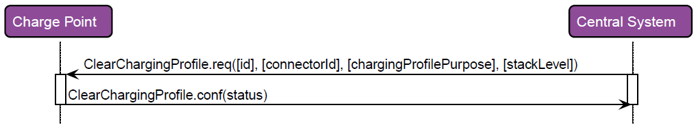

SendClearChargingProfile
SendClearChargingProfile 1:
With this method, an OCPP server sends a Clear Charging Profile request to the connected OCPP client. The response from the OCPP client is processed directly within the method.
