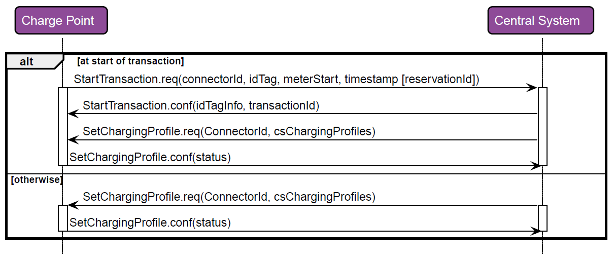

SendChargingProfile
SendChargingProfile 1:
With this method, an OCPP server sends a Charging Profile to the connected OCPP client. The response from the OCPP client is processed directly within the method.

The method returns the return value TRUE if the call was successful. A method call is also considered successfully completed in the event of an error.

The status indicates whether the Charging Profile has been accepted by the Charge Point.
