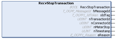

RecvStopTransaction
RecvStopTransaction 1:
With this method, an OCPP server receives a Stop Transaction request from the connected OCPP client. To respond to the request, the RespStopTransaction method must be called.
RecvStopTransaction 2:
Syntax
METHOD RecvStopTransaction : BOOL
    hMessageId     : T_OCPP_MessageId;
    sIdTag         : T_OCPP1_IdToken;
    nTransactionId : UDINT;
    nConnectorId   : UDINT;
    nMeterStop     : UDINT;
    nTimestamp     : ULINT;
    eReason        : E_OCPP1_Reason;
RecvStopTransaction 3: Return value
Type
RecvStopTransaction
The method returns the return value TRUE if the call was successful. A method call is also considered successfully completed in the event of an error.
RecvStopTransaction 4: Outputs
Type
hMessageId
T_OCPP_MessageId
MessageId of the received message.
sIdTag
T_OCPP1_IdToken
ID token for which the transaction is to be stopped.
nTransactionId
UDINT
ID of the transaction to be stopped. Is contained in the Central System's response to a Start Transaction request.
nConnectorId
UDINT
ID of the Connector of a Charge Point.
nMeterStop
UDINT
Value in watt-hours at the end of the transaction.
nTimestamp
ULINT
Date and time when the transaction is stopped.
eReason
E_OCPP1_Reason
Can optionally contain the reason for stopping the transaction.
