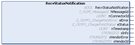

With this method, an OCPP server receives a Status Notification from the connected OCPP client. To respond to the Status Notification, the RespStatusNotification method must be called.
RecvStatusNotification 2:
Syntax
METHOD RecvStatusNotification : BOOL
    hMessageId   : T_OCPP_MessageId;
    nConnectorId : UDINT;
    eError       : E_OCPP1_ChargePointError;
    eStatus      : E_OCPP1_ChargePointStatus;
    nTimestamp   : ULINT := 0;
    sInfo        : STRING(63) := '';
    sVendorError : STRING(63) := '';
    sVendorId    : STRING(255) := '';
