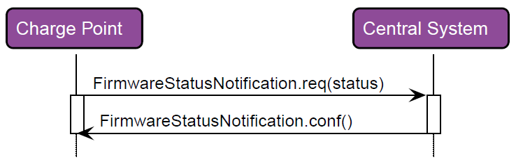

RecvFirmwareStatusNotification
RecvFirmwareStatusNotification 1:
With this method, an OCPP server receives a Firmware Status Notification from the connected OCPP client. To respond to the Firmware Status Notification, the RespFirmwareStatusNotification method must be called.
RecvFirmwareStatusNotification 2:
