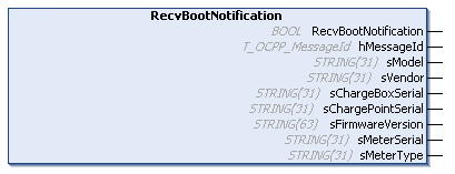

RecvBootNotification
RecvBootNotification 1:

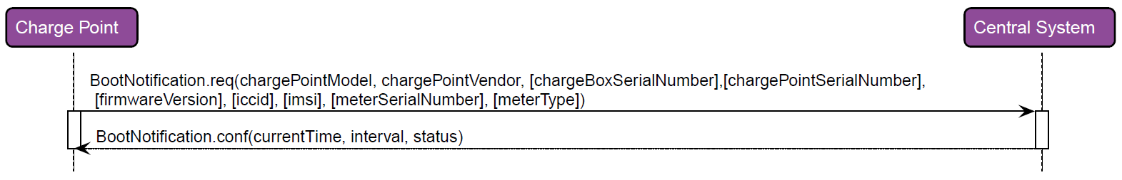

With this method, an OCPP server receives a Boot Notification from the connected OCPP client. To respond to the boot notification, the RespBootNotification method must be called.
RecvBootNotification 2:
Syntax
METHOD RecvBootNotification : BOOL
    hMessageId         : T_OCPP_MessageId;
    sModel             : STRING(31);
    sVendor            : STRING(31);
    sChargeBoxSerial   : STRING(31);
    sChargePointSerial : STRING(31);
    sFirmwareVersion   : STRING(63);
    sMeterSerial       : STRING(31);
    sMeterType         : STRING(31);
RecvBootNotification 3: Return value
Type
The method returns the return value TRUE if the call was successful. A method call is also considered successfully completed in the event of an error.
RecvBootNotification 4: Outputs
Type
hMessageId
T_OCPP_MessageId
MessageId of the received message.
sModel
STRING(31)
Model of the Charge Point.
sVendor
STRING(31)
Vendor of the Charge Point.
sChargeBoxSerial
STRING(31)
Serial number of the Charge Box within the Charge Point.
sChargePointSerial
STRING(31)
Serial number of the Charge Point.
sFirmwareVersion
STRING(63)
Firmware version of the Charge Point.
sMeterSerial
STRING(31)
Serial number of the main electricity meter of the Charge Point.
sMeterType
STRING(31)
Type of main electricity meter of the Charge Point
