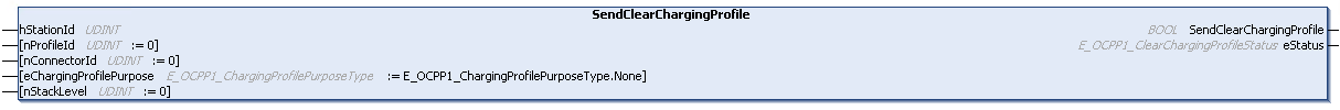

SendClearChargingProfile
SendClearChargingProfile 1:
With this method, an OCPP server sends a Clear Charging Profile request to the corresponding OCPP client. The response from the OCPP client is processed directly within the method.
SendClearChargingProfile 2:
Syntax
METHOD SendClearChargingProfile : BOOL
    hStationId              : UDINT;
    nProfileId              : UDINT := 0;
    nConnectorId            : UDINT := 0;
    eChargingProfilePurpose : E_OCPP1_ChargingProfilePurposeType := E_OCPP_ChargingProfilePurposeType.None;
    nStackLevel             : UDINT := 0;
    eStatus                 : E_OCPP1_ClearChargingProfileStatus;
SendClearChargingProfile 3: Return value
Type
The method returns the return value TRUE if the call was successful. A method call is also considered successfully completed in the event of an error.
SendClearChargingProfile 4: Inputs
Type
hStationId
UDINT
Identifier of the OCPP client in the instance of the OCPP server.
nProfileId
UDINT
Identifier of the Charging Profile to be cleared.
nConnectorId
UDINT
ID of the Connector of a Charge Point. The value 0 indicates that the clearing relates to the entire Charge Point.
Specifies the purpose of the Charging Profiles to be cleared.
nStackLevel
UDINT
Specifies the StackLevel for which Charging Profiles are cleared.
SendClearChargingProfile 5: Outputs
Type
eStatus
The status indicates whether the Charging Profile could be cleared from the Charge Point.
