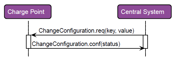

With this method, an OCPP server sends a Change Configuration request to the corresponding OCPP client. The response from the OCPP client is processed directly within the method.

The method returns the return value TRUE if the call was successful. A method call is also considered successfully completed in the event of an error.

E_OCPP1_ConfigurationStatus
The status indicates whether the configuration change has been accepted.
