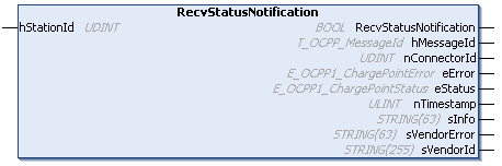

RecvStatusNotification
RecvStatusNotification 1:
With this method, an OCPP server receives a Status Notification from an OCPP client. To respond to the Status Notification, the method RespStatusNotification must be called.
RecvStatusNotification 2:
Syntax
METHOD RecvStatusNotification : BOOL
    hStationId   : UDINT;
    hMessageId   : T_OCPP_MessageId;
    nConnectorId : UDINT;
    eError       : E_OCPP1_ChargePointError;
    eStatus      : E_OCPP1_ChargePointStatus;
    nTimestamp   : ULINT := 0;
    sInfo        : STRING(63) := '';
    sVendorError : STRING(63) := '';
    sVendorId    : STRING(255) := '';
RecvStatusNotification 3: Return value
Type
The method returns the return value TRUE if the call was successful. A method call is also considered successfully completed in the event of an error.
RecvStatusNotification 4: Inputs
Type
hStationId
UDINT
Identifier of the OCPP client in the instance of the OCPP server.
RecvStatusNotification 5: Outputs
Type
hMessageId
T_OCPP_MessageId
MessageId of the received message.
nConnectorId
UDINT
ID of the Connector of a Charge Point.
eError
Error code received in the Status Notification.
eStatus
Status received in the Status Notification.
nTimestamp
ULINT
The timestamp of the Status Notification.
sInfo
STRING(63)
Contains optional, freely definable additional information on the error.
sVendorError
STRING(63)
Optionally contains the vendor-specific error code.
sVendorId
STRING(255)
Optionally contains the identifier for the vendor-specific implementation.
