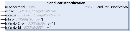

SendStatusNotification
SendStatusNotification 1:
With this method, an OCPP client sends a Status Notification to the corresponding OCPP server. The response from the OCPP server is processed directly within the method, but in this case it does not contain any separate variables anyway. The timestamp is set internally when the request is sent and cannot be set manually when the method is called.
SendStatusNotification 2:
Syntax
METHOD SendStatusNotification : BOOL
    nConnectorId : UDINT;
    eError       : E_OCPP1_ChargePointError;
    eStatus      : E_OCPP1_ChargePointStatus;
    sInfo        : STRING(50) := '';
    sVendorError : STRING(50) := '';
    sVendorId    : STRING(255) := '';
SendStatusNotification 3: Return value
Type
SendStatusNotificationEx
The method returns the return value TRUE if the call was successful. A method call is also considered successfully completed in the event of an error.
SendStatusNotification 4: Inputs
Type
nConnectorId
UDINT
ID of the Connector of a Charge Point.
eError
Error code to be sent in the Status Notification.
eStatus
Status to be sent in the Status Notification.
sInfo
STRING(50)
Contains optional, freely definable additional information on the error.
sVendorError
STRING(50)
Optionally contains the vendor-specific error code.
sVendorId
STRING(255)
Optionally contains the identifier for the vendor-specific implementation.
