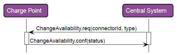

With this method, an OCPP client receives a Change Availability request from the corresponding OCPP server. To respond to the request, the method RespChangeAvailability must be called.

The method returns the return value TRUE if the call was successful. A method call is also considered successfully completed in the event of an error.
