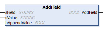

This method adds an additional header field to an instance of the function block FB_IotHttpHeaderFieldMap.
Syntax
METHOD AddField : BOOL
VAR_IN_OUT CONSTANT
    sField       : STRING;
    sValue       : STRING;
    bAppendValue : BOOL;
AddField 2: Return value
Type
AddField
Returns TRUE if the method call was successful.
AddField 3: Inputs
Type
bAppendValue
Replaces the existing header field value (FALSE) or appends the value to the existing value (TRUE).
AddField 4: Inputs/outputs
Type
sField
STRING
Name of the field that is added to the header of the HTTP request.
sValue
STRING
Value of the added header field.
