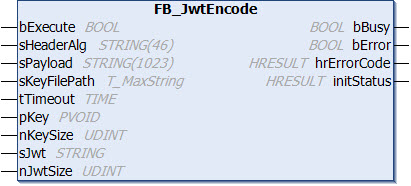

FB_JwtEncode
FB_JwtEncode 1:
The function block enables the creation and signing of a JSON Web Token (JWT).
Syntax
Definition:
FUNCTION_BLOCK FB_JwtEncode
  bExecute       : BOOL;
  sHeaderAlg     : STRING(46);
  sPayload       : STRING(1023);
  sKeyFilePath   : STRING(511);
  tTimeout       : TIME;
  pKey           : PVOID;
  nKeySize       : UDINT;
  nJwtSize       : UDINT;
VAR_IN_OUT CONSTANT
  sJwt           : STRING;
  bBusy          : BOOL;
  bError         : BOOL;
  hrErrorCode    : HRESULT;
  initStatus     : HRESULT;
FB_JwtEncode 2: Inputs
Type
bExecute
A rising edge activates processing of the function block.
sHeaderAlg
STRING(46)
The algorithm to be used for the JWT header, e.g. RS256.
sPayload
STRING(1023)
The JWT payload to be used.
sKeyFilePath
STRING(511)
Path to the private key to be used for the signature of the JWT.
tTimeout
TIME
ADS timeout, which is used internally for file access to the private key.
pKey
PVOID
Buffer for the private key to be read.
nKeySize
UDINT
Maximum size of the buffer.
sJwt
STRING
Contains the fully coded and signed JWT after the function block has been processed.
nJwtSize
UDINT
Size of the generated JWT including zero termination.
FB_JwtEncode 3: Outputs
Type
bBusy
Is TRUE as long as processing of the function block is in progress.
Becomes TRUE as soon as an error situation occurs.
hrErrorCode
HRESULT
Returns an error code if the bError output is set. An explanation of the possible error codes can be found in the Appendix.
initStatus
HRESULT
Returns an error code in case of a failed initialization of the function block.
Requirements
TwinCAT version
Hardware
Libraries to be integrated
TwinCAT 3.1, Build 4024.4
x86, x64, Arm®
Tc3_JsonXml 3.3.6.0
