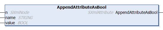

AppendAttributeAsBool
This method adds a new attribute to an existing node. The value of the attribute has the data type Boolean. The name and value of the new attribute and the existing XML node are transferred to the method as input parameters. The method returns a reference to the newly added attribute.
Syntax
METHOD AppendAttributeAsBool : SXmlAttribute
n : SXmlNode;
VAR_IN_OUT CONSTANT
value : BOOL;
Return value
Name | Type |
AppendAttributeAsBool | SXmlAttribute |
Inputs
Name | Type |
n | SXmlNode |
value | BOOL |
Inputs/Outputs
Name | Type |
name | STRING |
Sample call:
objAttribute := fbXml.AppendAttributeAsBool(objMachine, 'Name', TRUE);
