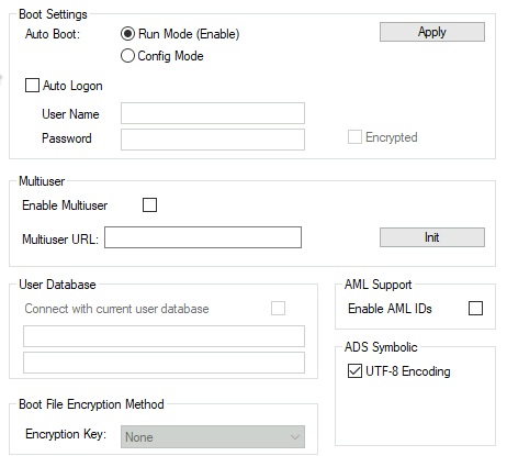

Attributes
If special characters are to be used in the attributes, a check mark can be set for the UTF-8 encoding of the ADS symbols in TwinCAT Build 3.1.4024.
Using UTF-8 characters 1:
With TwinCAT 3.1.4026, this setting is set by default. Therefore, it no longer needs to be set manually by the user.
