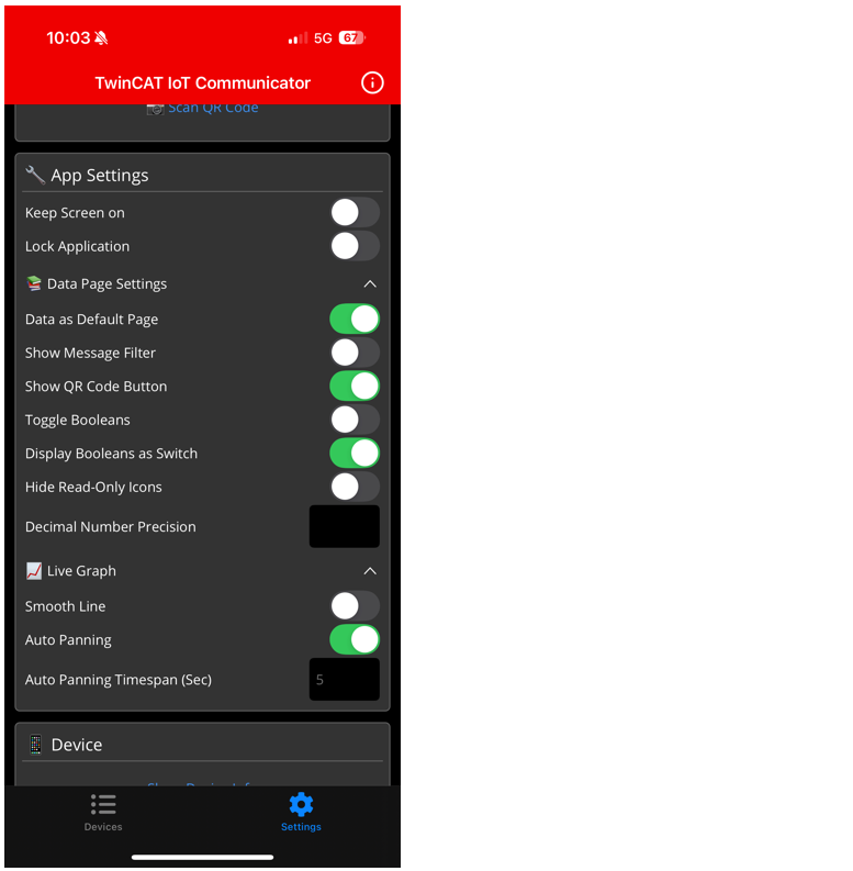

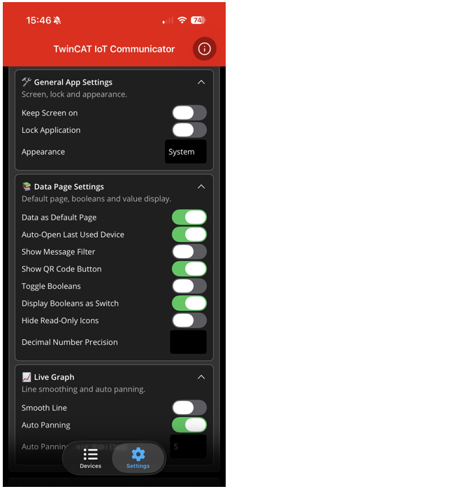

App settings
In addition to the connection settings, general settings can be made for the app. These are described below.
Setting | Meaning | Default |
Keep Screen on | When activated, the mobile device screen will not turn off while the app is open. | FALSE |
Lock Application | If activated, the set secure route of the operating system is used in order to protect the app against unauthorized access (Face-ID, Touch-ID, Code, etc.) | FALSE |
Appearance | The app can either adapt to the operating system's display settings or be manually set to Light or Dark mode. | System |
Data as Default Page | If activated, the Data tab is opened when opening a device, otherwise the Messages tab is opened. | TRUE |
Auto-Open Last Used Device | When opening the app, the last opened function block instance is automatically opened. This is useful, for example, if there is only one instance anyway. | FALSE |
Show Message Filter | When activated, messages on the message page can be filtered by category. | FALSE |
Show QR Code Button | A button for generating a QR code is displayed on each page within a Device. | TRUE |
Toggle Booleans | If this setting is activated, Boolean variables can be switched directly by pressing the display field. If inactive, a selection dialog opens on pressing the variable. This setting is only relevant if “Display Booleans as Switch” is FALSE. | FALSE |
Display Booleans as Switch | Boolean variables are displayed as switches. If this setting is disabled, these variables are displayed as a text field. | TRUE |
Hide Read-Only Icons | When activated, the lock icon for displaying read-only elements is hidden. There is then no way to recognize a read-only element. | FALSE |
Decimal Number Precision | Describes the number of decimal places to which REAL or LREAL values are rounded when displayed in the app. If a different value is defined on the PLC side for a single variable, the Decimal Number Precision for that variable is overwritten from the PLC. The value is also taken into account for variables within widgets. | This value is not set by default. |
Smooth Line | When displaying a live graph, the curve of the graph is shown rounded off if this feature is activated. | FALSE |
Auto Panning | If activated, the graph is trimmed to a certain timespan. | TRUE |
Auto Panning Timespan | The timespan to which a graph is trimmed in the Live View. | 5 s |
