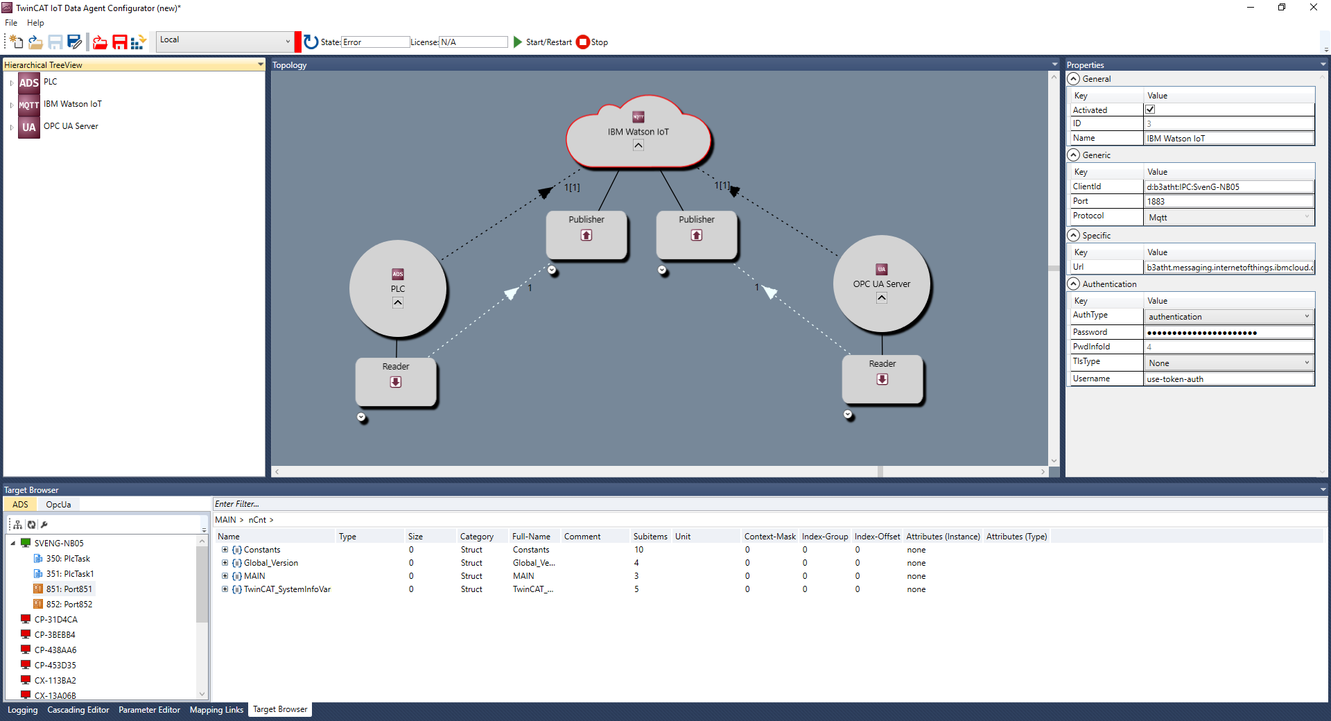

Follow the step-by-step instructions to create a mapping between source and destination symbols. Note that a mapping can only be created between channels that have different roles (e.g. between a subscriber and a publisher channel and vice versa).
Drag-and-drop - Channel:
While holding the CTRL key, drag the subscriber channel to the publisher channel.
The configurator automatically creates new symbols on the publisher channel and a mapping between the source and destination symbol.
Drag-and-drop – Symbol:
While holding the CTRL key, drag a symbol from the subscriber channel to either an existing symbol on the publisher channel or to the publisher channel itself.
The configurator creates a link between source and destination symbol or, if the symbol has been dragged to a channel object, creates the destination symbol automatically

The resulting configuration may look like this:
