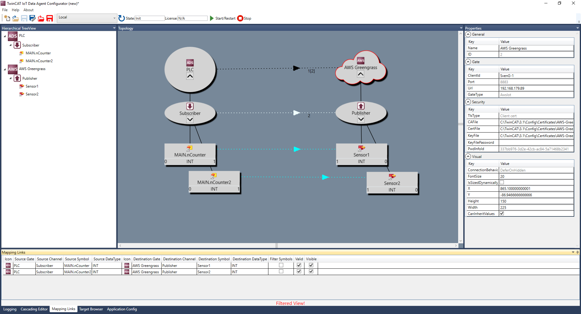

The resulting configuration looks like this:
Publish data to AWS Greengrass 3:
