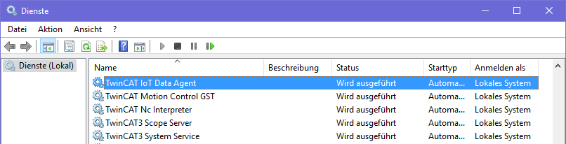

TC3 IoT Data Agent is automatically installed as a Windows service that runs under the local system context (and is therefore independent of the user account logged in) and starts automatically during system boot.
After starting the TC3 IoT Data Agent, the core application waits for a trigger command to start the communication. The trigger command is usually send via the configurator or the system tray application (see Configurator and System tray). You can also configure an AutoStart option per configuration file by using the graphical configurator tool.
