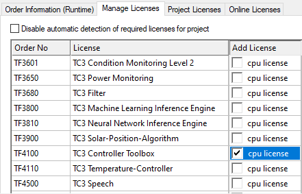

4. In the Solution Explorer, double-click License in the SYSTEM subtree.
Licensing 1:
  • The TwinCAT 3 license manager opens.
5. Open the Manage Licenses tab. In the Add License column, check the check box for the license you want to add to your project (e.g. "TF6420: TC3 Database Server").

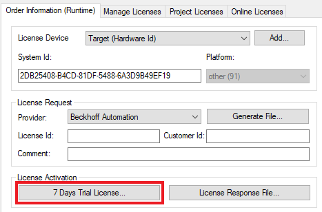

6. Open the Order Information (Runtime) tab.
  • In the tabular overview of licenses, the previously selected license is displayed with the status “missing”.
7. Click 7-Day Trial License... to activate the 7-day trial license.
Licensing 3:
  • A dialog box opens, prompting you to enter the security code displayed in the dialog.
    Licensing 4:
8. Enter the code exactly as it is displayed and confirm the entry.
9. Confirm the subsequent dialog, which indicates the successful activation.
  • In the tabular overview of licenses, the license status now indicates the expiry date of the license.
10. Restart the TwinCAT system.
  • The 7-day trial version is enabled.
