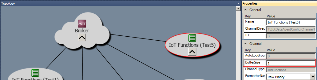

Message buffer
TC3 IoT Data Agent includes a message buffer for incoming messages that should be used by TC3 IoT Functions. This message buffer can be set directly on the corresponding TC3 IoT Functions channel.
