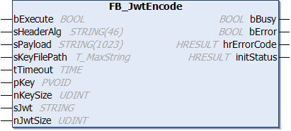

FB_JwtEncode
The function block enables the creation and signing of a JSON Web Token (JWT).

Inputs
Name | Type | Description |
bExecute | BOOL | A rising edge activates processing of the function block. |
sHeaderAlg | STRING(46) | The algorithm to be used for the JWT header, e.g. RS256. |
sPayload | STRING(1023) | The JWT payload to be used. |
sKeyFilePath | STRING(511) | Path to the private key to be used for the signature of the JWT. |
tTimeout | TIME | ADS timeout, which is used internally for file access to the private key. |
pKey | PVOID | Buffer for the private key to be read. |
nKeySize | UDINT | Maximum size of the buffer. |
sJwt | Contains the fully coded and signed JWT after the function block has been processed. | |
nJwtSize | Size of the generated JWT including zero termination. |
Outputs
bBusy | BOOL | Is TRUE as long as processing of the function block is in progress. |
bError | BOOL | Becomes TRUE as soon as an error situation occurs. |
hrErrorCode | HRESULT | Returns an error code if the |
initStatus | HRESULT | Returns an error code in case of a failed initialization of the function block. |
