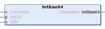

SetBase64
This method sets the value of a property to a Base64-coded value. A data structure, for example, can be used as the source. Coding to the Base64 format takes place inside the method.
Syntax
METHOD SetBase64 : SJsonValue
v : SJsonValue;
p : PVOID;
n : DINT;
Return value
Name | Type |
SetBase64 | SJsonValue |
Inputs
Name | Type |
v | SJsonValue |
p | PVOID |
n | DINT |
