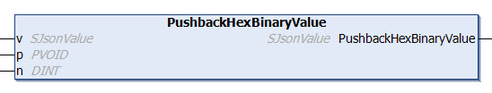

This method appends a HexBinary value to the end of an array. The coding in the HexBinary format is executed by the method. A data structure, for example, can be used as the source.

METHOD PushbackHexBinaryValue : SJsonValue
v : SJsonValue;
p : PVOID;
n : DINT;
Return value
Name | Type |
PushbackHexBinaryValue | SJsonValue |
Inputs
Name | Type |
v | sJsonValue |
p | PVOID |
n | DINT |
