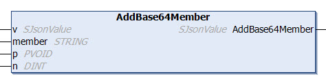

This method adds a Base64 member to a JSON object. A structure, for example, can be addressed as an input parameter. The corresponding Base64 coding is done by the method.

Sample call:
jsonDoc := fbJson.ParseDocument(sExistingJsonDocument);
jsonBase64 := fbJson.AddBase64Member(jsonDoc, 'TestBase64', ADR(stStruct), SIZEOF(stStruct));
