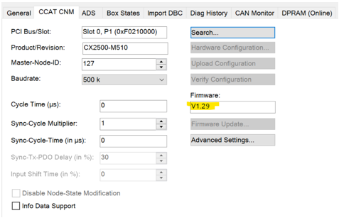

TwinCAT Version 4024.12 or higher is to be used when using the M510 CAN optional interface with the Embedded PCs or the FC512x. The version of the CCAT driver should be V1.29 or higher:
Necessary firmware version 1:
