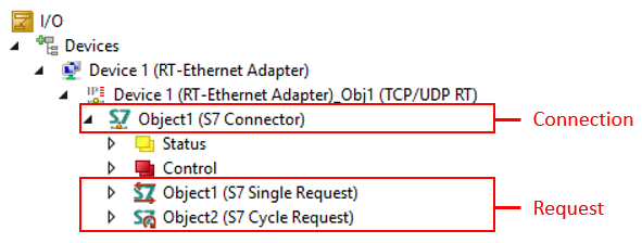

Maximum frame size per request | Siemens S7 Controllers have a maximum frame size per request. This is reported by the controller when the communication is started up and is approximately 960 bytes for most S7 types. If more than 960 bytes are created in the process image, the TwinCAT S7 communication driver automatically splits the requests into several requests. |
Maximum number of connections | The function TF6620 is based on the TwinCAT TCP/UDP RT stack, which allows a maximum of 32 connections (per stack) as standard. Additionally, there may also be limitations on the part of the Siemens S7 Controller regarding the simultaneous number of TCP/IP connections. |
Maximum number of requests per connection | A maximum of 64 messages per connection can be configured. However, this number can be increased by additional connections. |
