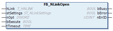

FB_NLinkOpen
This function block (actively) establishes a network connection to the third-party system. If successful, the internal parameters of the hLink variable are initialised. The same instance of the hLink variable must then be transferred to the other instances of the communication blocks FB_NLinkFetch, FB_NLinkWrite or FB_NLinkClose. In a PLC application one instance of this variables is required for each network connection (TwinCAT system<->Ethernet LAN adapter<->external controller).
hLink : T_HNLINK;
hLink : Network connection handle ( Type:T_HNLINK). The instance of this variable is required by the other communication blocks and is transferred to them via VAR_IN_OUT.
stSettings : ST_NLinkSettings := ( sHost := '127.0.0.1', nPort := 2002 );
nOpt : DWORD := 0;
bExecute : BOOL;
tTimeout : TIME := T#45s;
END_VARstSettings: Structure with configuration settings for the communication connection. The member variables of this structure should contain parameters such as port number, host name, etc.
nOpt: Reserved for future applications.
bExecute: The block is activated by a rising edge at this input.
tTimeout: Specifies the timeout that must not be exceeded on receipt of the command.
bBusy : BOOL;
bError : BOOL;
nErrID : UDINT;
bBusy: When the function block is activated this output is set. It remains set until a feedback is received. While Busy = TRUE, no new command will be accepted at the inputs. Please note that it is not the command execution but the receipt of the command that is monitored.
bError: In the event of an error during the command transfer, this output is set once the bBusy output has been reset.
nErrID: Supplies the error number when the bError output is set.
