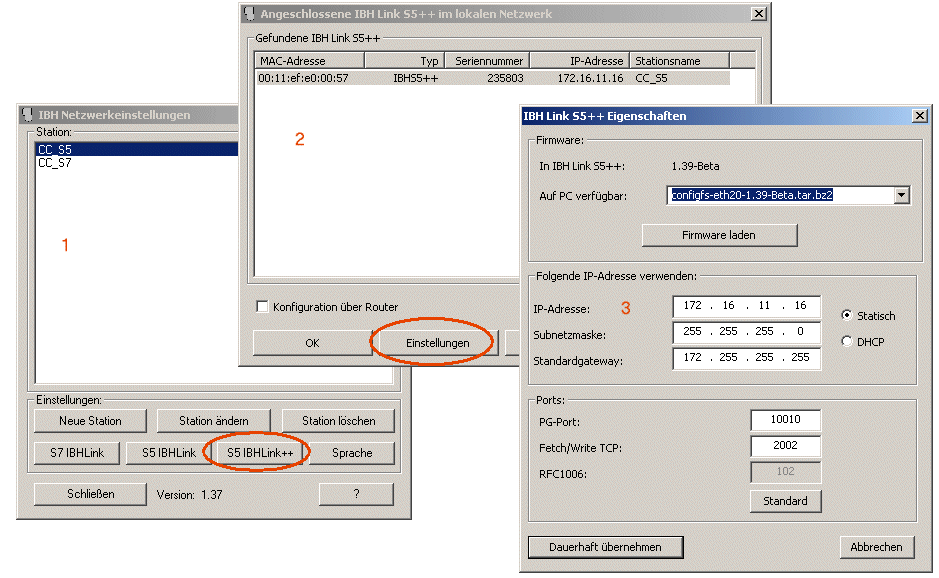

Configuration of an IBH Link S5++ adapter
In the following example a fixed IP address 172.16.11.16 was set:

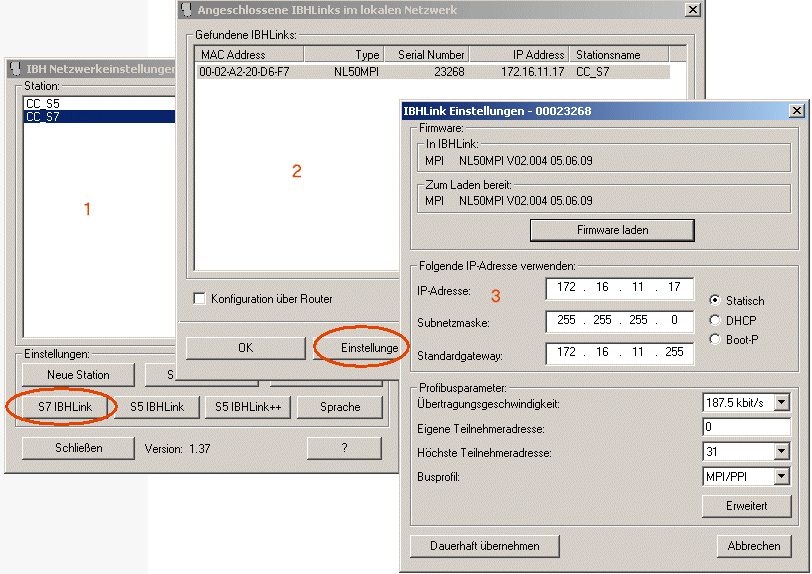

Configuration of an IBH Link S5/S7 ++ adapter 1:
Configuration of an IBH Link S7++ adapter
In the following example a fixed IP address 172.16.11.17 was set:
Configuration of an IBH Link S5/S7 ++ adapter 2:
