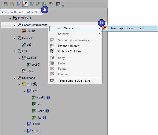

Report Control Blocks can be generated via a button in the toolbar (a), or alternatively from the context menu in the data model tree under ReportControlBlocks (b).
Reporting 1:

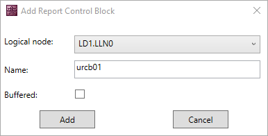

It is possible to create Buffered or Unbuffered report control blocks. The assignment to a Logical Node can be selected in the dialog, as can an appropriate name.
Reporting 2:

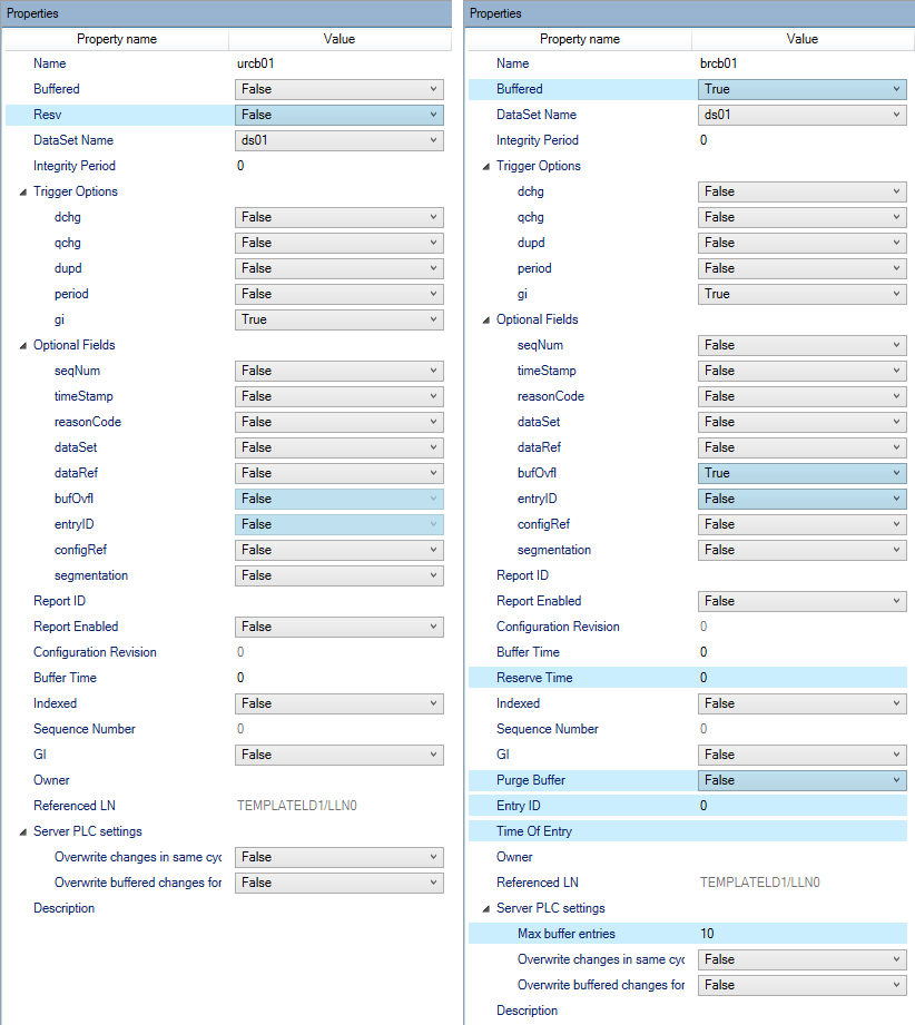

If you select a created Report Control Block in the tree, you can make settings in the properties. Depending on whether it is an unbuffered or buffered Report Control Block, different default settings are available.
In addition to the default settings, there are settings for the PLC server. Further information can be found in chapter Server - Buffered Reporting.
Reporting 3:
