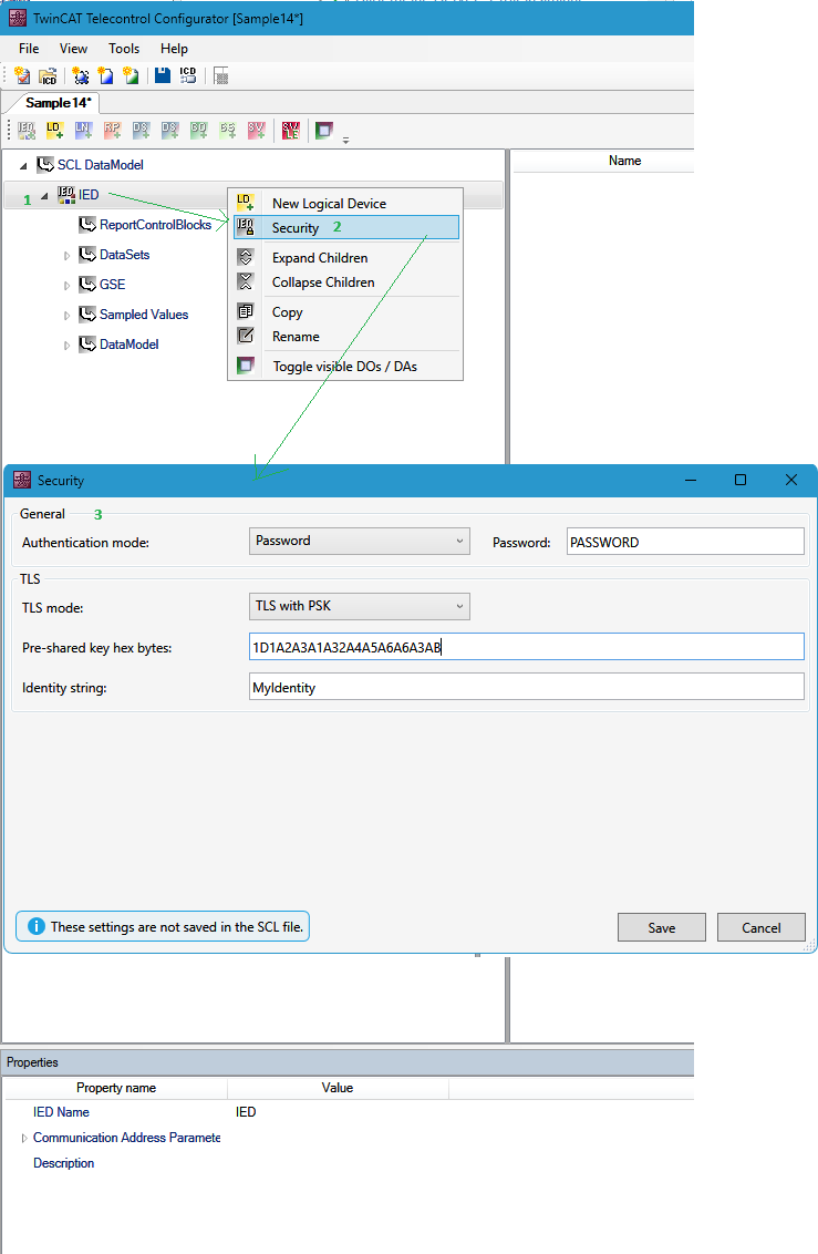

Activation and configuration of the authentication function in the TwinCAT Telecontrol Configurator
In the simplest variant, the authentication function can already be activated in the TwinCAT Telecontrol Configurator. The settings required for this can be found in the Security configuration dialog. This dialog can be accessed via the context menu of the IED device (right-mouse click on the IED device and then select Security from the menu). As shown in the image below, please set the parameter: Authentication mode to the value: Password.
Authentication, negotiation of supported services and optional communication parameters 1:
