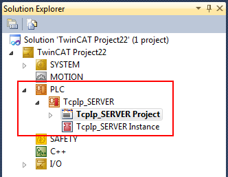

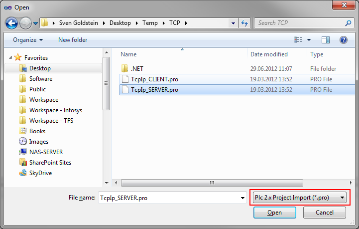

- 4. In the Open dialog, select the file type "Plc 2.x Project Import (*.pro)", browse to the folder containing your TwinCAT 2 PLC project and select the corresponding.pro file and click Open.

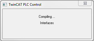

- TwinCAT 3 starts the converter process and finally displays the converted PLC project under the “PLC“ node.
