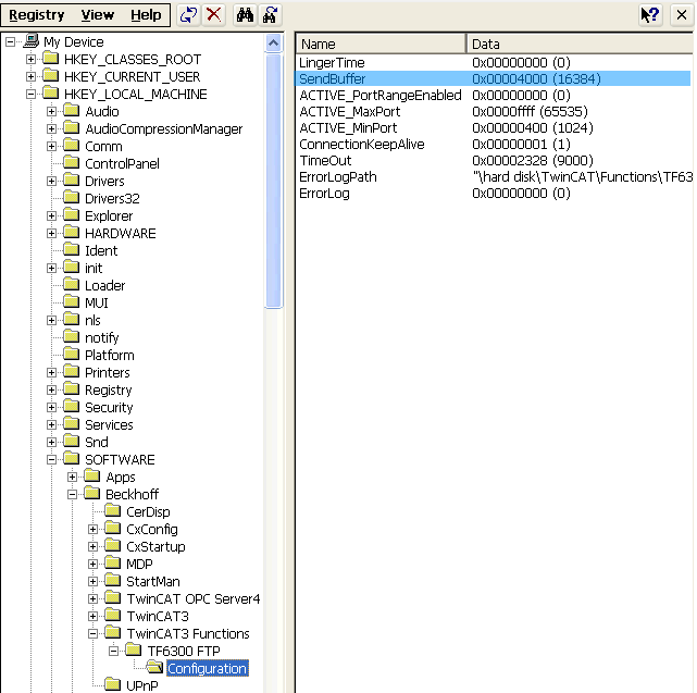

The transmission speed of the TwinCAT FTP Client can be regulated using the transmit buffer. This can be set in the registry under the following key.
"HKEY_LOCAL_MACHINE\Software\Beckhoff\TwinCAT3 Functions\TF6300 FTP\Configuration\SendBuffer"
Setting the transmit buffer 2:
The value is specified in bytes. The default value is 16 kB.
