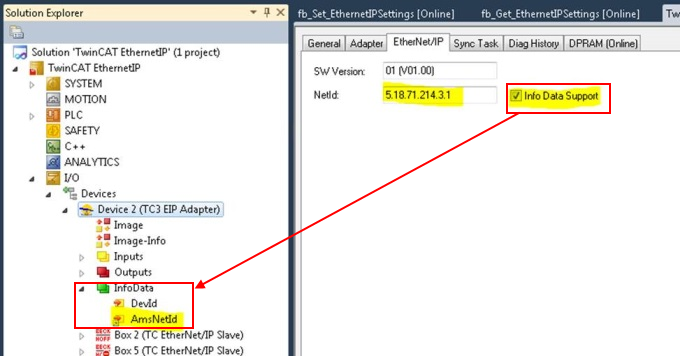

AmsNetId
The AMSNetId can be found under the EtherNet/IP tab in the NetID field. When you select the option Info Data Support it is linked directly.
The advantage of a direct link is that it always retrieves the current AMSNETID, even if controllers are used that use different AMSNETIDs. The AMSNETID of the EtherNet/IP™ adapter therefore does not have to be read manually.
