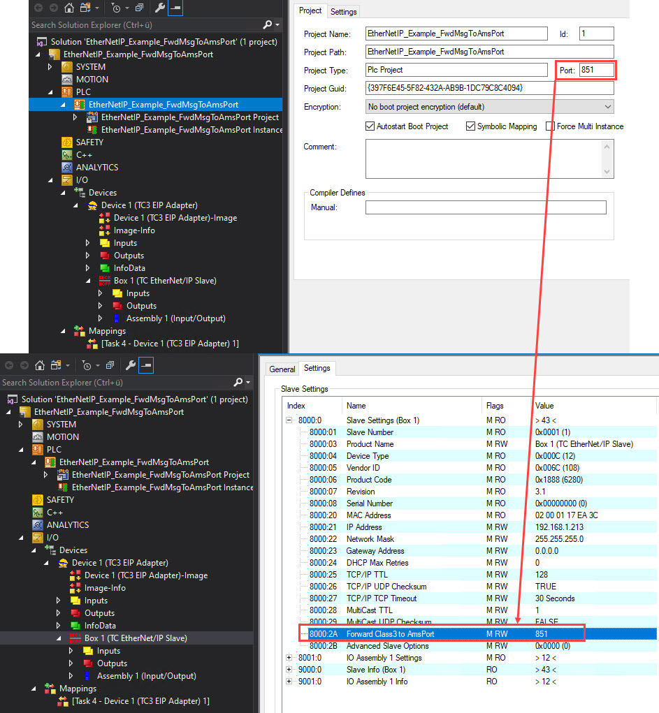

- 1. To enable the FwdMsgToAmsPort feature, enter the AmsPort of the PLC (in the example 851) in the slave/master settings (0x8000:2A/0xF800:2A) in TwinCAT.

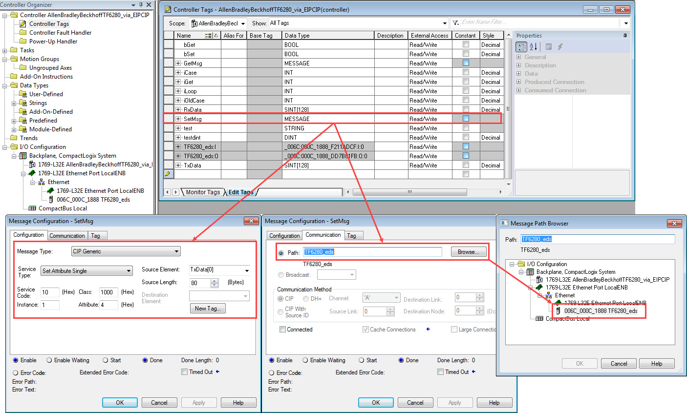

Implementation RS Logix 5000:

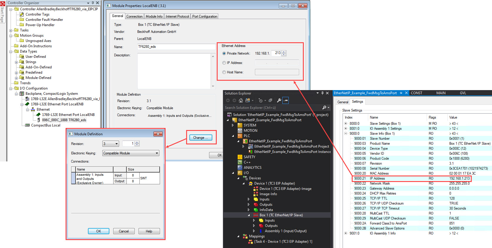

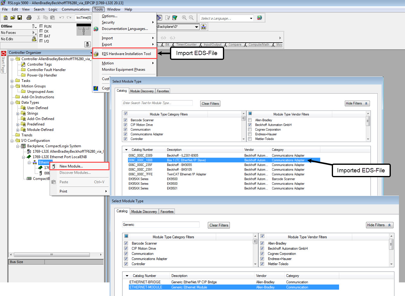

- 1. At the beginning you have to create a new module, either a "Generic Ethernet Module" or an EDS file exported from TwinCAT.
The advantage of the imported EDS file is that it already contains the size of the process data created in the TwinCAT configuration. - 2. In the settings of the attached module you may have to adjust the IP and the process data settings.

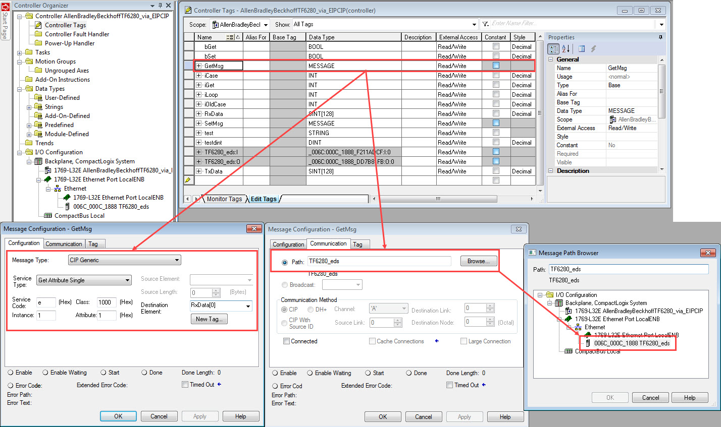

- 3. To be able to send and receive messages acyclically, structures of the type "Messages" are necessary.
In the sample, one structure is used for sending and one for receiving. You must configure both structures accordingly for sending and for receiving. - 4. Right-click on the tag SetMsg-Configure SetMsg to open the configuration settings. These are to be taken over as indicated in the screenshot.
The specifications Class, Instance and Attribute are freely selectable. At Service Type set Set Attributes Single. At Source Element, create an array whose contents are to be sent. Select the Source Length so that it does not exceed the length of the target variable created in TwinCAT. - 5. Right-click on the tag GetMsg - Configure GetMsg to open the configuration settings. These are to be taken over as indicated in the screenshot.
The specifications Class, Instance and Attribute are freely selectable. At Service Type set Get Attribute Single. Create an array at Destination Element that receives the acyclic messages. The size of the array is to be chosen according to the receiving messages.
- The following sample code sends requests to the EtherNet/IP™ driver of the TF6280, which forwards them to the TwinCAT PLC for further processing.
A single attribute value is read from the TwinCAT PLC with a positive edge at "bGet". In this sample the values "TestReadOnlyAttribute1, TestReadOnlyAttribute2 and TestReadOnlyAttribute3" can be read.
A single attribute value is written to the TwinCAT PLC with a positive edge at "bSet". In this sample the fourth attribute in the TwinCAT PLC can be described with the content "123Beckhoff567" and "HelloBeckhoff".
