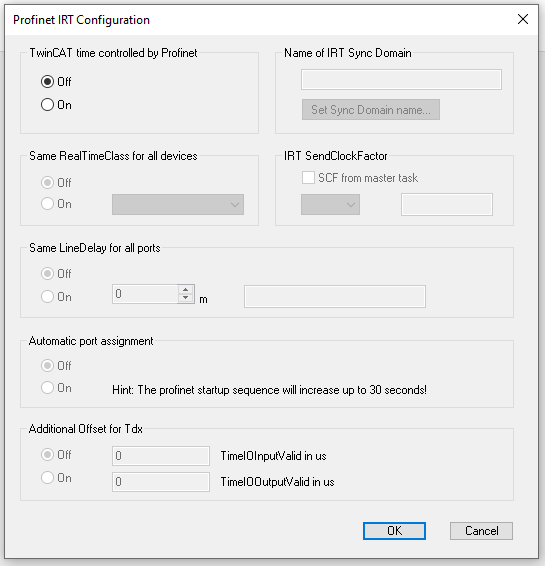

IRT configuration
This menu is only available for an IRT-capable device.
For the device, it is currently only possible to determine whether the TwinCAT time should be adjusted to the PROFINET time. All other settings are projected by the controller.
