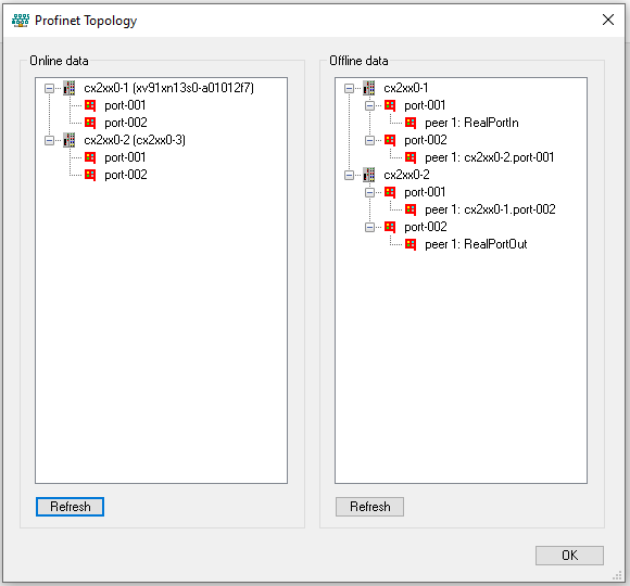

Topology
The online topology can be compared with the offline topology via this dialog.
Topology 1:
Starting with build 4024 on the PROFINET Device, it is also possible to simulate a port interconnection when using virtual devices. For this purpose, interconnection between the projected devices can take place offline and be checked in this dialog. The online window displays the interconnection projected by the controller. For more information, see the chapter
