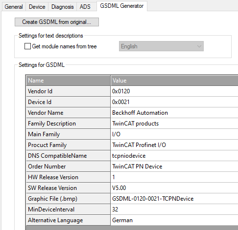

A GSDML can be created from an existing configuration via this window. The generated file can then be integrated into the controller. The device configuration is thus set and does not need to be reconfigured on the controller side.
If the names in the tree have been adjusted, this change can be applied here optionally. To do this, the associated language must be selected. The texts are then accepted under this language in the GSDML. If several languages are to be adapted, the generated GSDML must first be reintegrated into the TwinCAT system, then the tree must be re-edited in the desired language and the GSDML must be regenerated with this language.
![]() | Existing languages remain unchanged, only the selected language is replaced with the texts. |
