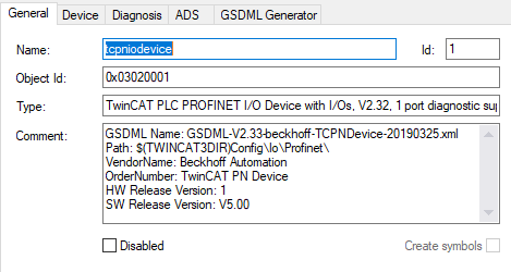

General
Here you can find general information about the PROFINET device used.
General 1:
The name used can be edited directly here. A change is accepted in the tree. In the case of the controller, this also sets the PROFINET station name. For the device, the PROFINET station name is set only if the corresponding option is selected (Get StationName from Tree).
More information about the used GSDML can be found in the comment box.
