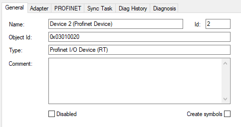

General
General 1:
Identifier for the PROFINET Device protocol object.
Id
The device ID is set by the TwinCAT System Manager during configuration and cannot be configured by the user.
Object Id
Identification number of the PROFINET Device protocol object in the TwinCAT object context.
Type
Shows the selected object type and its property.
Comment
Freely editable comment to describe the object used.
Disabled
This option sets the PROFINET Device to inactive (transparent) for the current configuration. If this option is activated, the corresponding object is ignored in the IO configuration
Create symbols
Creating variables as symbolic names.
