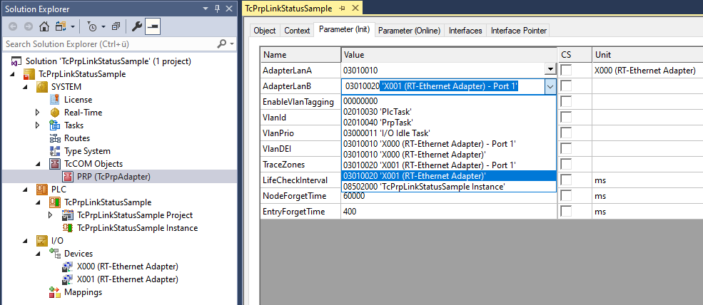

2. On the TwinCAT PRP module, here with the name PRP, select the two RT-Ethernet Adapters at Parameters (Init) for the LAN-A and LAN-B
Reading the link status 2:

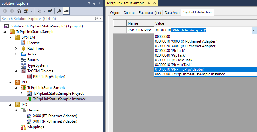

3. In the PLC project an interface pointer to the TwinCAT PRP module is used. Configure this interface pointer with the Symbol Initialization to select and assign the Object ID from the TwinCAT PRP module.
Reading the link status 3:

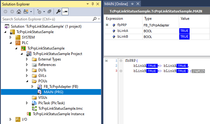

4. Activate the TwinCAT project and start the PLC project.
Both adapters should indicate an active link by having the variables bLinkA and bLinkB both TRUE.
Reading the link status 4:
For example, if you now disconnect the Ethernet cable from the adapter X001, this is immediately detected and indicated by a change of the variable bLinkB to FALSE.
Reading the link status 5:
