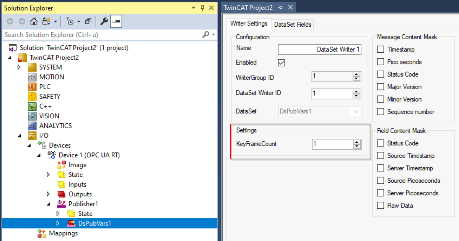

KeyFrames and DeltaFrames
KeyFrames always contain the full data set whereas DeltaFrames only include incremental updates (fields that have changed). When configuring a Publisher data set, the KeyFrameCount specifies how often a KeyFrame should be published related to the publishing interval.
KeyFrames, DeltaFrames, KeepAlive 1:
When set to "1", a KeyFrame is published in every Publisher cycle. When set to a value greater than "1", a KeyFrame is published every n cycles, otherwise a DeltaFrame is published. Please note that Delta-Frames are only published if there is a data change, which means that there may be times in which no Frames are published at all.
