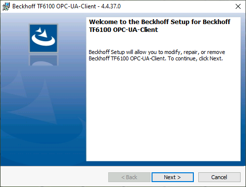

TwinCAT 3 Setup
If you are using TwinCAT 3.1 Build 4024 on the Microsoft Windows operating system, you can install this function via a setup package, which you can download from the Beckhoff website at https://www.beckhoff.com/download.
Depending on the system on which you need the function, the installation can be done on either the engineering or runtime side. The following screenshot shows an example of the setup interface using the TF6100 TwinCAT OPC UA Client setup.
Installation 2:
To complete the installation process, follow the instructions in the Setup dialog.

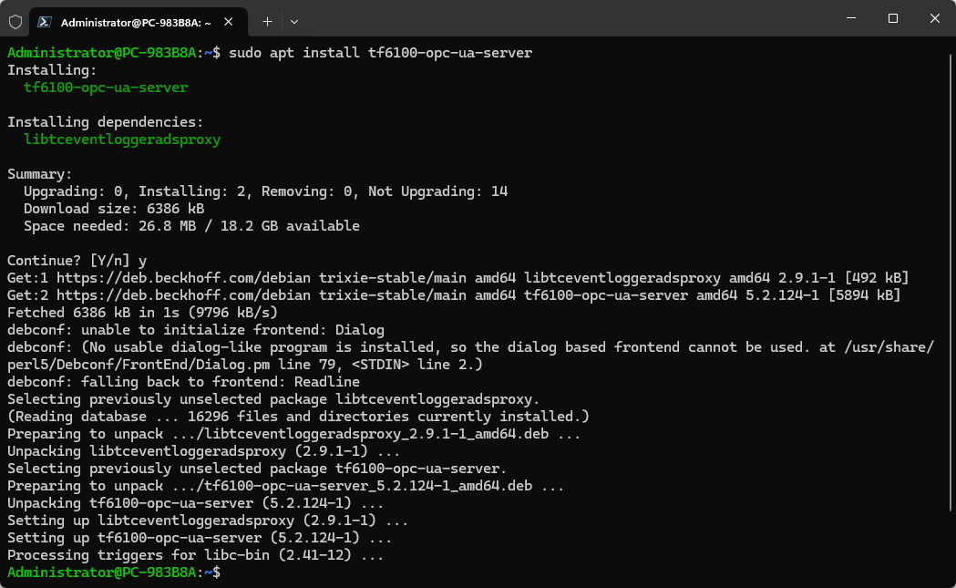

Beckhoff RT Linux®
1. Use the CLI directly on your device. Alternatively, you can also connect via SSH.
2. Log in as an administrator.
3. Update the packages in the Package Manager.
sudo apt update
4. Search for the existing TF6100 packages.
sudo apt search tf6100
5. Install TF6100 OPC UA server via the Package Manager.
sudo apt install tf6100-opc-ua-server
The TF6100 OPC UA server is installed.

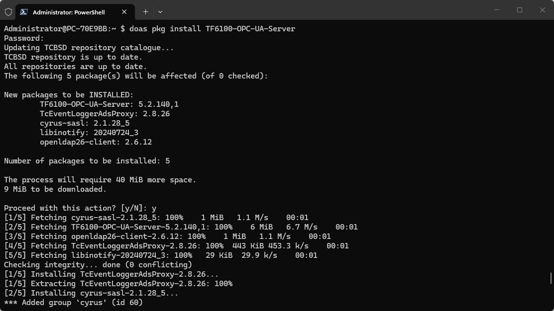

TwinCAT/BSD
doas pkg update
doas pkg search TF6100
5. Install TF610x OPC UA client PubSub via the Package Manager.
doas pkg install TF6100-OPC-UA-Server
