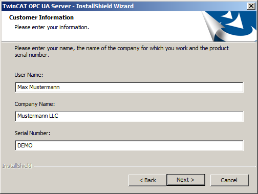

Licensing under TwinCAT 2
The product is licensed under TwinCAT 2 during installation; a corresponding text field allows you to enter a license key. To evaluate this product, you can activate it for a period of 30 days. To do this, enter "Demo" as the license key.
