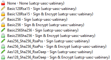

All endpoints in the list can be enabled or disabled via the gateway configuration. In the following figure, all endpoints are enabled.
