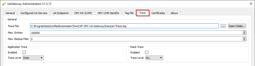

You can enable a log file in the gateway for extended diagnostics, in which various information is then recorded on the basis of different log levels.
Logging 1:
Influence of logging on the operating behavior
Please note that activating the log file can have a negative impact on the speed and operating behavior of the TwinCAT OPC UA Gateway.
The default path for the created log files is described in more detail in the chapter Application directories and can also be viewed in the TwinCAT OPC UA Gateway configurator.
