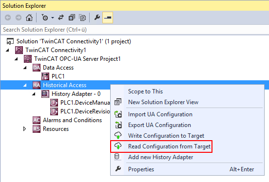

Opening a partial configuration
Use the command Read Configuration from Target in the context menu of a specific facet of the configuration to open the partial configuration of the selected target device.

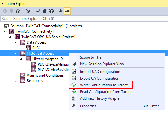

Downloading a partial configuration
Use the command Write Configuration to Target in the context menu of a specific facet of the configuration to download the partial configuration to the selected target device.
