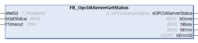

FB_OpcUAServerGetStatus
The function block enables the current status (Running, NotResponding) of a TwinCAT OPC UA Server to be read. It should be noted at this point that this function block deals with the ADS interface of the OPC UA Server. If the OPC UA Server is restarted or shut down, the ADS interface of the server remains accessible. The ADS interface can only be closed by terminating the server process.
Syntax
Definition:
FUNCTION_BLOCK FB_OpcUAServerGetStatus
sNetId : T_AmsNetId;
bGetStatus : BOOL;
tTimeout : TIME;
eOPCUAServerStatus : E_OPCUAServerStatus;
bDone : BOOL;
bBusy : BOOL;
bError : BOOL;
nErrorId : UDINT;
Inputs
Name | Type | Description |
sNetId | T_AmsNetId | AmsNetId of the system on which the TwinCAT OPC UA Server runs. |
bGetStatus | BOOL | A rising edge activates processing of the function block. |
tTimeout | TIME | ADS Timeout |
Outputs
eOPCUAServerStatus | Contains status information about the server. | |
bDone | BOOL | TRUE when processing of the function block is complete. |
bBusy | BOOL | TRUE as long as processing of the function block is in progress. |
bError | BOOL | Becomes TRUE as soon as an error situation occurs. |
nErrorId | UDINT | Contains the error code when an error (bError) occurs. |
