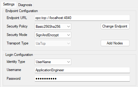

Username/Password
This type of authentication uses a username/password combination to authenticate the TwinCAT OPC UA Client to the server application. Below you will find an example screenshot from the TwinCAT OPC UA I/O Client.
Authentication 2:

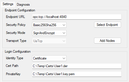

User certificate
With this type of authentication, the TwinCAT OPC UA Client uses a certificate to authenticate itself to the server application. The handling of user certificates on the server side is identical to the use of certificates on the transport layer, i.e. the server must trust the (user) certificate before the client can successfully authenticate itself to the server with the certificate. Below you will find an example screenshot from the TwinCAT OPC UA I/O Client.
Authentication 3:
